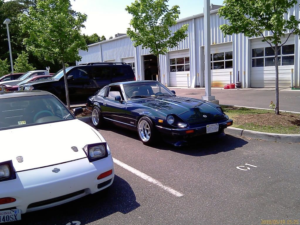

Rebuilt 81 L28ET with a 85 Z31T ECU, Isuzu NPR intercooler, Z31 ignition, 3"/2.5" exhaust, recirc'd SSQV, 10psi, pulsar seats, 75 280Z intake mani, Kamei air dam, and a Flexalite dual E-fan...rust is creeping back unfortunately, the SSR XR-4s on the car are worth more than the car, haha.
It's not fast fast but it gets rolling well enough, gets 21ish mpg just beating around usually.
